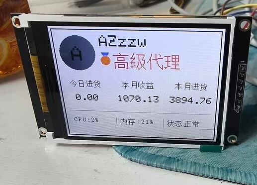

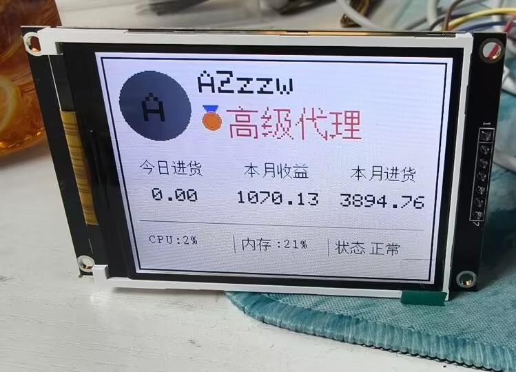

闲的没事AI做了一个代理收益统计
纯测试AI能力,不要在评论里开喷拉屎
先看效果图:
你需要的材料:
  1. ESP32 - S3
  2. 一个TFT屏幕(st7789)
  3. 一个2.4G的WIFI

    dashboardVisible = false;
    lcd.fillScreen(ST77XX_BLACK);
    lcd.setCursor(12, 16);
    lcd.setTextColor(ST77XX_GREEN);
    lcd.setTextSize(2);
    lcd.println("WiFi connected");
    lcd.setTextColor(ST77XX_WHITE);
    lcd.setCursor(12, 56);
    lcd.print("IP: ");
    lcd.println(WiFi.localIP());
    lcd.setCursor(12, 88);
    lcd.print("RSSI: ");
    lcd.print(WiFi.RSSI());
    lcd.println(" dBm");
void showDashboard(const DashboardData& data)
    dashboardVisible = true;
    lcd.fillScreen(ST77XX_WHITE);
    lcd.setTextWrap(false);
    lcd.drawRect(4, 4, 312, 232, ST77XX_BLACK);
    lcd.drawRect(5, 5, 310, 230, ST77XX_BLACK);
    lcd.fillCircle(48, 50, 34, 0x9CF3);
    lcd.setTextColor(ST77XX_BLACK);
    lcd.setTextSize(4);
    lcd.setCursor(36, 37);
    lcd.write(data.name.length() > 0 ? data.name.charAt(0) : '?');
    lcd.setTextSize(3);
    lcd.setCursor(92, 15);
    lcd.print(data.name.substring(0, 11));
    if (data.isAgent)
        lcd.fillTriangle(94, 48, 101, 59, 108, 48, ST77XX_BLUE);
        lcd.fillCircle(101, 63, 9, 0xFD20);
        lcd.drawCircle(101, 63, 6, 0xFBE0);
        drawChineseText(116, 48, "高级代理", ST77XX_RED, 2);
    else
        lcd.setTextColor(0xFD20);
        lcd.setTextSize(3);
        lcd.setCursor(112, 52);
        lcd.print(data.vipLevel);
        drawChineseText(132, 52, "级会员", 0xFD20, 2);
    drawChineseText(24, 105, "今日进货", ST77XX_BLACK);
    drawChineseText(128, 105, "本月收益", ST77XX_BLACK);
    drawChineseText(232, 105, "本月进货", ST77XX_BLACK);
    drawCenteredValue(56, 136, data.stockDaily);
    drawCenteredValue(160, 136, data.monthlyIncome);
    drawCenteredValue(264, 136, data.stockMonthly);
    lcd.drawFastHLine(14, 174, 292, 0xC618);
    drawStatusBar();
bool readDashboardData(DashboardData& dashboard)
    const unsigned long requestNumber = ++resellRequestCount;
    const unsigned long requestStartedAt = millis();
    Serial.println();
    Serial.println("========== 分销数据请求开始 ==========");
    Serial.print("请求编号:");
    Serial.println(requestNumber);
    Serial.print("请求时间:");
    Serial.print(requestStartedAt / 1000);
    Serial.println(" 秒");
    Serial.print("请求地址:");
    Serial.println(userApiUrl);
    Serial.print("WiFi 状态:");
    Serial.println(WiFi.status() == WL_CONNECTED ? "已连接" : "未连接");
    Serial.print("RSSI:");
    Serial.print(WiFi.RSSI());
    Serial.println(" dBm");
    WiFiClientSecure client;
    client.setInsecure();
    client.setTimeout(HTTP_TIMEOUT);
    HTTPClient http;
    if (!http.begin(client, userApiUrl))
        Serial.println("无法创建 HTTPS 请求");
        Serial.print("本次请求耗时:");
        Serial.print(millis() - requestStartedAt);
        Serial.println(" ms");
        return false;
    http.setConnectTimeout(HTTP_TIMEOUT);
    http.setTimeout(HTTP_TIMEOUT);
    http.setReuse(false);
    http.addHeader("x-api-key", rainyunApiKey);
    const int httpCode = http.GET();
    if (httpCode <= 0)
        Serial.print("请求失败:");
        Serial.println(http.errorToString(httpCode));
        http.end();
        return false;
    const String response = http.getString();
    Serial.print("HTTP 状态码:");
    Serial.println(httpCode);
    Serial.print("响应长度:");
    Serial.print(response.length());
    Serial.println(" 字节");
    http.end();
    if (httpCode != HTTP_CODE_OK)
        Serial.println("HTTP 状态不是 200,跳过 JSON 数据读取");
        Serial.println("========== 分销数据请求结束(失败) ==========");
        return false;
    DynamicJsonDocument document(4096);
    const DeserializationError error = deserializeJson(document, response);
    if (error)
        Serial.print("JSON 解析失败:");
        Serial.println(error.c_str());
        return false;
    JsonObject data = document.as<JsonObject>();
    if (document["data"].is<JsonObject>())
        data = document["data"].as<JsonObject>();
    if (data["Name"].isNull() ||
        data["StockDaily"].isNull() ||
        data["StockMonthly"].isNull() ||
        data["ResellPointsMonthly"].isNull())
        Serial.println("响应中缺少仪表盘字段");
        Serial.println("需要字段:Name、StockDaily、StockMonthly、ResellPointsMonthly");
        return false;
    dashboard.name = data["Name"].as<String>();
    dashboard.stockDaily = data["StockDaily"].as<double>();
    dashboard.stockMonthly = data["StockMonthly"].as<double>();
    dashboard.monthlyIncome = data["ResellPointsMonthly"].as<double>() / 2000.0;
    dashboard.vipLevel = data["VipLevel"] | 1;
    dashboard.isAgent = data["IsAgent"] | false;
    Serial.println("解析后的仪表盘数据:");
    Serial.print("  名称:");
    Serial.println(dashboard.name);
    Serial.print("  今日进货:");
    Serial.println(dashboard.stockDaily, 4);
    Serial.print("  本月收益:");
    Serial.println(dashboard.monthlyIncome, 4);
    Serial.print("  本月进货:");
    Serial.println(dashboard.stockMonthly, 4);
    Serial.println("========== 分销数据请求结束(成功) ==========");
    return true;
void updateResellData()
    if (WiFi.status() != WL_CONNECTED)
        Serial.println("[API] WiFi 未连接,跳过本次数据请求");
        return;
    Serial.println("开始更新 LCD 分销数据...");
    DashboardData dashboard;
    if (readDashboardData(dashboard))
        showDashboard(dashboard);
        Serial.println("LCD 仪表盘更新完成");
    else
        Serial.println("[API] 本次更新失败,保留 LCD 上一次成功数据");
void maintainWiFi(unsigned long now)
    if (now - lastWiFiCheck < WIFI_CHECK_INTERVAL)
        return;
    lastWiFiCheck = now;
    const bool isConnected = WiFi.status() == WL_CONNECTED;
    if (isConnected)
        wifiDisconnectedSince = 0;
        if (!wasWiFiConnected)
            Serial.println("[WiFi] 已恢复连接");
            Serial.print("[WiFi] IP 地址:");
            Serial.println(WiFi.localIP());
            Serial.print("[WiFi] RSSI:");
            lastResellRequest = now - RESELL_REFRESH_INTERVAL;
            drawStatusBar();
        wasWiFiConnected = true;
        return;
    if (wasWiFiConnected)
        Serial.println("[WiFi] 检测到连接已断开");
        drawStatusBar();
    wasWiFiConnected = false;
    if (wifiDisconnectedSince == 0)
        wifiDisconnectedSince = now;
    if (now - lastWiFiReconnectAttempt >= WIFI_RECONNECT_INTERVAL)
        lastWiFiReconnectAttempt = now;
        if (now - wifiDisconnectedSince < WIFI_HARD_RECONNECT_AFTER)
            Serial.println("[WiFi] 正在尝试软重连...");
            WiFi.reconnect();
        else
            Serial.println("[WiFi] 持续断线,重新启动 STA 连接...");
            WiFi.disconnect(false, false);
            delay(50);
            WiFi.begin(ssid, password);
void setup()
    Serial.begin(115200);
    const unsigned long serialWaitStartedAt = millis();
    while (!Serial && millis() - serialWaitStartedAt < 3000)
        delay(10);
    delay(200);
    Serial.println();
    Serial.println("[BOOT] Serial monitor started at 115200 baud");
    Serial.flush();
    initializeLcd();
    lcd.setTextColor(ST77XX_YELLOW);
    lcd.setTextSize(2);
    lcd.println("Connecting WiFi...");
    Serial.println();
    Serial.println("========== ESP32 启动 ==========");
    Serial.println("ESP32开始连接WiFi...");
    WiFi.mode(WIFI_STA);
    WiFi.setSleep(false);
    WiFi.setAutoReconnect(true);
    WiFi.persistent(false);
    Serial.println("[WiFi] 省电模式已关闭,自动重连已启用,凭据不重复写入 Flash");
    // No WiFi.config() call: obtain IP address from the router via DHCP.
    const unsigned long connectStartedAt = millis();
    while (WiFi.status() != WL_CONNECTED && millis() - connectStartedAt < WIFI_CONNECT_TIMEOUT)
        delay(500);
        Serial.print(".");
    Serial.println();
    Serial.print("分销数据刷新间隔:");
    Serial.print(RESELL_REFRESH_INTERVAL / 1000);
    wasWiFiConnected = WiFi.status() == WL_CONNECTED;
        Serial.println("连接成功!");
        Serial.print("IP地址:");
        Serial.print("信号强度RSSI:");
        showWiFiInfo();
        updateResellData();
    else
        Serial.println("[WiFi] 首次连接超时,将在后台继续重连");
    lastResellRequest = millis();
    lastWiFiReconnectAttempt = millis();
    initializeCpuMonitor();
void loop()
    const unsigned long now = millis();
    if (now >= SYSTEM_RESTART_INTERVAL)
        Serial.println("[SYSTEM] 已运行 5 分钟,正在执行软件复位...");
        Serial.flush();
        delay(50);
        ESP.restart();
    maintainWiFi(now);
    updateCpuUsage(now);
    if (now - lastSerialHeartbeat >= SERIAL_HEARTBEAT_INTERVAL)
        lastSerialHeartbeat = now;
        Serial.print("[HEARTBEAT] uptime=");
        Serial.print(now / 1000);
        Serial.print("s, WiFi=");
        Serial.print(WiFi.status() == WL_CONNECTED ? "connected" : "disconnected");
        Serial.print(", CPU=");
        if (cpuMonitorCalibrated)
            Serial.print(cpuUsagePercent);
            Serial.println('%');
        else
            Serial.println("calibrating");
    if (WiFi.status() == WL_CONNECTED && now - lastResellRequest >= RESELL_REFRESH_INTERVAL)
        Serial.println();
        Serial.println("达到刷新间隔,准备请求最新数据");
        updateResellData();
        Serial.print("下一次刷新倒计时:");
//命名为ChineseFont16.h,这个是字模
#pragma once
#include <Arduino.h>
struct ChineseGlyph16
    uint16_t codepoint;
    uint8_t bitmap[32];
const ChineseGlyph16 CHINESE_FONT_16[] PROGMEM = {
    {0x4ECA, {0x80,0x00,0x80,0x00,0x40,0x01,0x20,0x02,0x10,0x04,0x48,0x08,0x84,0x10,0x83,0x60,0x00,0x00,0xf8,0x0f,0x00,0x08,0x00,0x04,0x00,0x04,0x00,0x02,0x00,0x01,0x80,0x00}},
    {0x65E5, {0x00,0x00,0xf8,0x0f,0x08,0x08,0x08,0x08,0x08,0x08,0x08,0x08,0x08,0x08,0xf8,0x0f,0x08,0x08,0x08,0x08,0x08,0x08,0x08,0x08,0x08,0x08,0x08,0x08,0xf8,0x0f,0x08,0x08}},
    {0x8FDB, {0x00,0x09,0x04,0x09,0x08,0x09,0xc8,0x3f,0x00,0x09,0x00,0x09,0x0f,0x09,0xe8,0x7f,0x08,0x09,0x08,0x09,0x88,0x08,0x88,0x08,0x48,0x08,0x14,0x00,0xe2,0x7f,0x00,0x00}},
    {0x8D27, {0x10,0x01,0x10,0x01,0x08,0x19,0x0c,0x07,0xea,0x21,0x09,0x21,0x08,0x3e,0x00,0x00,0xf8,0x0f,0x08,0x08,0x88,0x08,0x88,0x08,0x88,0x08,0x40,0x06,0x30,0x18,0x0e,0x20}},
    {0x672C, {0x80,0x00,0x80,0x00,0x80,0x00,0x80,0x00,0xfe,0x3f,0xc0,0x01,0xa0,0x02,0xa0,0x02,0x90,0x04,0x88,0x08,0x84,0x10,0xf2,0x27,0x81,0x40,0x80,0x00,0x80,0x00,0x80,0x00}},
    {0x6708, {0xe0,0x3f,0x20,0x20,0x20,0x20,0x20,0x20,0x20,0x20,0xe0,0x3f,0x20,0x20,0x20,0x20,0x20,0x20,0xe0,0x3f,0x20,0x20,0x20,0x20,0x10,0x20,0x10,0x20,0x08,0x28,0x04,0x10}},
    {0x6536, {0x10,0x02,0x10,0x02,0x12,0x02,0x12,0x01,0x12,0x7f,0x92,0x10,0x52,0x11,0x12,0x11,0x12,0x11,0x1a,0x0a,0x16,0x0a,0x12,0x04,0x10,0x0a,0x10,0x11,0x90,0x20,0x50,0x40}},
    {0x76CA, {0x08,0x08,0x10,0x04,0x00,0x00,0xff,0x7f,0x00,0x00,0x10,0x04,0x08,0x08,0x04,0x10,0x02,0x20,0xfc,0x1f,0x24,0x12,0x24,0x12,0x24,0x12,0x24,0x12,0xff,0x7f,0x00,0x00}},
    {0x5185, {0x80,0x00,0x80,0x00,0x80,0x00,0xfe,0x3f,0x82,0x20,0x82,0x20,0x82,0x20,0x42,0x21,0x42,0x22,0x22,0x24,0x12,0x28,0x0a,0x28,0x02,0x20,0x02,0x20,0x02,0x28,0x02,0x10}},
    {0x5B58, {0x20,0x00,0x20,0x00,0xff,0x7f,0x10,0x00,0x10,0x00,0xc8,0x1f,0x08,0x08,0x0c,0x04,0x0a,0x02,0xe9,0x7f,0x08,0x02,0x08,0x02,0x08,0x02,0x08,0x02,0x88,0x02,0x08,0x01}},
    {0x72B6, {0x10,0x02,0x10,0x12,0x10,0x22,0x12,0x22,0x14,0x02,0xf4,0x7f,0x10,0x02,0x10,0x02,0x18,0x02,0x14,0x05,0x13,0x05,0x10,0x09,0x90,0x08,0x90,0x10,0x50,0x20,0x30,0x40}},
    {0x6001, {0x80,0x00,0x80,0x00,0xfe,0x3f,0x80,0x00,0x40,0x01,0x20,0x02,0x50,0x04,0x8c,0x18,0x03,0x60,0x80,0x00,0x10,0x11,0x12,0x21,0x12,0x48,0x12,0x48,0xe1,0x0f,0x00,0x00}},
    {0x6B63, {0x00,0x00,0xfe,0x3f,0x80,0x00,0x80,0x00,0x80,0x00,0x80,0x00,0x88,0x00,0x88,0x1f,0x88,0x00,0x88,0x00,0x88,0x00,0x88,0x00,0x88,0x00,0x88,0x00,0xff,0x7f,0x00,0x00}},
    {0x5E38, {0x80,0x00,0x88,0x08,0x90,0x04,0xfe,0x7f,0x02,0x40,0xf9,0x2f,0x08,0x08,0xf8,0x0f,0x80,0x00,0xfc,0x1f,0x84,0x10,0x84,0x10,0x84,0x14,0x84,0x08,0x80,0x00,0x80,0x00}},
    {0x65AD, {0x20,0x00,0x20,0x20,0xaa,0x1e,0x72,0x02,0x22,0x02,0xfe,0x02,0x22,0x7e,0x72,0x12,0xaa,0x12,0xa6,0x12,0x22,0x12,0x22,0x12,0x02,0x12,0xfe,0x11,0x00,0x11,0x80,0x10}},
    {0x5F00, {0x00,0x00,0xfe,0x3f,0x10,0x04,0x10,0x04,0x10,0x04,0x10,0x04,0x10,0x04,0xff,0x7f,0x10,0x04,0x10,0x04,0x10,0x04,0x10,0x04,0x08,0x04,0x08,0x04,0x04,0x04,0x02,0x04}},
    {0x9AD8, {0x40,0x00,0x80,0x00,0xff,0x7f,0x00,0x00,0xf0,0x07,0x10,0x04,0x10,0x04,0xf0,0x07,0x00,0x00,0xfe,0x3f,0x02,0x20,0xf2,0x27,0x12,0x24,0x12,0x24,0xf2,0x27,0x02,0x30}},
    {0x7EA7, {0x08,0x00,0xc8,0x3f,0x04,0x21,0x04,0x11,0x12,0x11,0x1f,0x09,0x08,0x39,0x04,0x21,0x82,0x22,0x9f,0x22,0x82,0x14,0x80,0x14,0x58,0x08,0x47,0x14,0x22,0x22,0x80,0x41}},
    {0x4EE3, {0x10,0x09,0x10,0x11,0x10,0x11,0x08,0x01,0x08,0x7d,0xec,0x03,0x0c,0x01,0x0a,0x02,0x09,0x02,0x08,0x02,0x08,0x04,0x08,0x44,0x08,0x48,0x08,0x50,0x08,0x60,0x08,0x40}},
    {0x7406, {0x00,0x00,0x80,0x3f,0xbf,0x24,0x88,0x24,0x88,0x3f,0x88,0x24,0x88,0x24,0xbe,0x3f,0x08,0x04,0x08,0x04,0x88,0x3f,0x08,0x04,0x38,0x04,0x07,0x04,0xc2,0x7f,0x00,0x00}},
    {0x4F1A, {0x80,0x00,0x80,0x00,0x40,0x01,0x20,0x02,0x10,0x04,0x0c,0x18,0xf3,0x67,0x00,0x00,0x00,0x00,0xfe,0x3f,0x40,0x00,0x20,0x00,0x10,0x04,0x08,0x08,0xfc,0x1f,0x08,0x10}},
    {0x5458, {0x00,0x00,0xf8,0x0f,0x08,0x08,0x08,0x08,0xf8,0x0f,0x00,0x00,0xfc,0x1f,0x04,0x10,0x84,0x10,0x84,0x10,0x84,0x10,0x84,0x10,0x44,0x13,0x20,0x0c,0x18,0x10,0x06,0x20}}
constexpr size_t CHINESE_FONT_16_COUNT = sizeof(CHINESE_FONT_16) / sizeof(CHINESE_FONT_16[0]);
主要通过雨云API接口实现,有能力可自行二改开板
这个好玩欸
